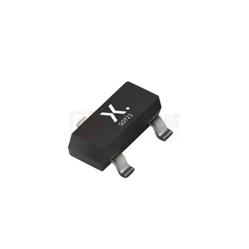

NUP1301QA Ultra low capacitance ESD protection array 13 November 2017 Product data sheet 1. General description Ultra low capacitance ElectroStatic Discharge (ESD) protection array in a leadless ultra small DFN1010D-3 (SOT1215) Surface-Mounted Device (SMD) plastic package with visible and solderable side pads, designed to protect one signal line in rail-to-rail configuration from the damage caused by ESD and other transients. 2. Features and benefits • • • • • • • ESD protection of one signal line (rail-to-rail configuration) Ultra low diode capacitance: Cd = 2.3 pF Very low reverse leakage current: ≤ 30 nA ESD protection up to 30 kV ESD robustness exceeds IEC 61000-4-2; level 4 (ESD) IEC 61000-4-5 (surge); IPP = 11 A at tp = 8/20 μs AEC-Q101 qualified 3. Applications • • • • • • • Telecommunication networks Video line protection Microcontroller protection 2 I C-bus protection Antenna power supply Analog audio Class-D amplifier 4. Quick reference data Table 1. Quick reference data Symbol Parameter Conditions Min Typ Max Unit VR reverse voltage Tamb = 25 °C - - 80 V IR reverse current VR = 25 V; Tamb = 25 °C - 7 30 nA VR = 80 V; Tamb = 25 °C - 50 500 nA f = 1 MHz; VR = 0 V; Tamb = 25 °C; Pin 1 - pin 3 - 0.5 0.75 pF f = 1 MHz; VR = 0 V; Tamb = 25 °C; Pin 2 - pin 3 - 1.8 2 pF f = 1 MHz; VR = 0 V; Tamb = 25 °C; Pin 3 - pins 1 and 2 - 2.3 2.75 pF Per diode Cd diode capacitance NUP1301QA Nexperia Ultra low capacitance ESD protection array 5. Pinning information Table 2. Pinning information Pin Symbol Description Simplified outline 1 A1 anode (diode 1) 2 K2 cathode (diode 2) 3 K1, A2 cathode (diode 1) and anode (diode 2) 4 K1, A2 cathode (diode1) and anode (diode2) Graphic symbol 1 A1 4 K1, A2 3 K2 2 aaa-022858 Transparent top view DFN1010D-3 (SOT1215) 6. Ordering information Table 3. Ordering information Type number Package NUP1301QA Name Description Version DFN1010D-3 DFN1010D-3: plastic thermal enhanced ultra thin small outline package; no leads; 3 terminals; body 1.1 x 1.0 x 0.37 mm SOT1215 7. Marking Table 4. Marking codes Type number Marking code NUP1301QA X 110 MARKING CODE (EXAMPLE) READING DIRECTION YEAR DATE CODE VENDOR CODE PIN 1 INDICATION MARK MARK-FREE AREA READING EXAMPLE: 11 01 10 Fig. 1. aaa-008041 DFN1010D-3 (SOT1215) binary marking code description NUP1301QA Product data sheet All information provided in this document is subject to legal disclaimers. 13 November 2017 © Nexperia B.V. 2017. All rights reserved 2 / 13 NUP1301QA Nexperia Ultra low capacitance ESD protection array 8. Limiting values Table 5. Limiting values In accordance with the Absolute Maximum Rating System (IEC 60134). Symbol Parameter Conditions Min Max Unit VR reverse voltage Tamb = 25 °C - 80 V IF forward current pulsed; tp ≤ 300 µs; δ ≤ 0.02 ; single diode loaded; Tamb = 25 °C - 290 mA pulsed; tp ≤ 300 µs; δ ≤ 0.02 ; double diode loaded; Tamb = 25 °C - 170 mA Per diode IFRM repetitive peak forward current tp ≤ 500 µs; δ ≤ 0.25 ; Tj = 25 °C - 700 mA IFSM non-repetitive peak forward current square wave; tp = 100 µs - 4 A square wave; tp = 1 ms - 1.5 A square wave; tp = 1 s - 0.5 A - 11 A Per device IPPM rated peak pulse current tp = 8/20 μs [1] [2] Tj junction temperature - 150 °C Tamb ambient temperature -55 150 °C Tstg storage temperature -65 150 °C - 30 kV ESD maximum ratings VESD [1] [2] [3] electrostatic discharge voltage IEC 61000-4-2 (contact discharge) [2] [3] Non-repetitive current pulse 8/20 μs exponential decay waveform according to IEC 61000-4-5. Measured from pin 3 to pins 1 and 2 (pins 1 and 2 are connected). Device stressed with ten non-repetitive ESD pulses. 001aaa631 001aaa630 120 IPP 100 % 100 % IPP; 8 µs IPP (%) 80 90 % e-t 50 % IPP; 20 µs 40 10 % 0 0 10 20 30 t (µs) t tr = 0.6 ns to 1 ns 40 30 ns 60 ns Fig. 2. 8/20 µs pulse waveform according to IEC 61000-4-5 NUP1301QA Product data sheet Fig. 3. ESD pulse waveform according to IEC 61000-4-2 All information provided in this document is subject to legal disclaimers. 13 November 2017 © Nexperia B.V. 2017. All rights reserved 3 / 13 NUP1301QA Nexperia Ultra low capacitance ESD protection array 9. Characteristics Table 6. Characteristics Symbol Parameter Conditions Min Typ Max Unit VBR breakdown voltage IR = 0.1 mA; Tamb = 25 °C 100 - - V VF forward voltage IF = 1 mA; Tamb = 25 °C [1] - - 715 mV IF = 10 mA; Tamb = 25 °C [1] - - 855 mV IF = 50 mA; Tamb = 25 °C; Pulse [1] - - 1 V IF = 150 mA; Tamb = 25 °C [1] - - 1.25 V VR = 25 V; Tamb = 25 °C - 7 30 nA VR = 80 V; Tamb = 25 °C - 50 500 nA VR = 25 V; Tj = 150 °C - - 30 µA VR = 80 V; Tj = 150 °C - - 150 µA f = 1 MHz; VR = 0 V; Tamb = 25 °C; Pin 1 - pin 3 - 0.5 0.75 pF f = 1 MHz; VR = 0 V; Tamb = 25 °C; Pin 2 - pin 3 - 1.8 2 pF f = 1 MHz; VR = 0 V; Tamb = 25 °C; Pin 3 - pins 1 and 2 - 2.3 2.75 pF TLP = 10 A; positive; Tamb = 25 °C - 0.55 - Ω TLP = 10 A; negative; Tamb = 25 °C - 0.3 - Ω Per diode IR reverse current Cd diode capacitance Rdyn dynamic resistance Per device VCL [1] [2] [3] clamping voltage IPP = 1 A; Tamb = 25 °C [2] [3] - - 3 V IPP = 11 A; Tamb = 25 °C [2] [3] - - 10 V Pulse test: tp ≤ 300 μs; δ ≤ 0.02. Non-repetitive current pulse 8/20 μs exponential decay waveform according to IEC 61000-4-5. Measured from pin 3 to pins 1 and 2 (pins 1 and 2 are connected). NUP1301QA Product data sheet All information provided in this document is subject to legal disclaimers. 13 November 2017 © Nexperia B.V. 2017. All rights reserved 4 / 13 NUP1301QA Nexperia Ultra low capacitance ESD protection array aaa-021945 1 aaa-020909 10 IF (A) IFSM (A) 10-1 (1) (2) 10-2 1 (3) (4) 10-3 10-4 0.0 0.5 1.0 1.5 VF (V) 10-1 10-1 2.0 (1) Tj = 150 °C (2) Tj = 85 °C (3) Tj = 25 °C (4) Tj = −40 °C Fig. 4. IR (A) 1 102 10 tp (ms) 103 Based on square wave currents. Tamb = 25 °C Fig. 5. Non-repetitive forward current as a function of pulse duration; maximum values Forward current as a function of forward voltage; typical values aaa-020907 10-3 10-4 Cd (pF) (1) 10-5 1.5 (2) 10-6 aaa-020908 2.0 (3) 10-7 1.0 (4) 10-8 10-9 0.5 (5) 10-10 10-11 0 20 40 60 80 VR (V) (1) Tj = 150 °C (2) Tj = 125 °C (3) Tj = 85 °C (4) Tj = 25 °C (5) Tj = −40 °C Fig. 6. 0.0 100 0 5 10 15 20 VR (V) 25 f = 1 MHz; Tamb = 25 °C; pin 2 to GND Fig. 7. Diode capacitance as a function of reverse voltage; typical values Reverse current as a function of reverse voltage; typical values NUP1301QA Product data sheet All information provided in this document is subject to legal disclaimers. 13 November 2017 © Nexperia B.V. 2017. All rights reserved 5 / 13 NUP1301QA Nexperia Ultra low capacitance ESD protection array ESD TESTER acc. to IEC 61000-4-2 CZ = 150 pF; RZ = 330 Ω 4 GHz DIGITAL OSCILLOSCOPE RZ 450 Ω RG 223/U 50 Ω coax 10x ATTENUATOR CZ 50 Ω DUT (DEVICE UNDER TEST) vertical scale = 10 V/div horizontal scale = 15 ns/div vertical scale = 10 A/div horizontal scale = 15 ns/div GND GND clamped +8 kV ESD pulse waveform (IEC 61000-4-2 network), pin 3 to 1 and 2 unclamped +8 kV ESD pulse waveform (IEC 61000-4-2 network) vertical scale = 10 V/div horizontal scale = 15 ns/div vertical scale = 10 A/div horizontal scale = 15 ns/div GND GND clamped -8 kV ESD pulse waveform (IEC 61000-4-2 network), pin 3 to 1 and 2 unclamped -8 kV ESD pulse waveform (IEC 61000-4-2 network) Fig. 8. aaa-027349 ESD clamping test setup and waveforms NUP1301QA Product data sheet All information provided in this document is subject to legal disclaimers. 13 November 2017 © Nexperia B.V. 2017. All rights reserved 6 / 13 NUP1301QA Nexperia Ultra low capacitance ESD protection array aaa-027350 30 IPP (A) 25 -5 20 -10 15 -15 10 -20 5 -25 0 0 5 10 15 20 -30 -30 25 30 VCL (V) tp = 100 ns; Transmission Line Pulse (TLP) Fig. 9. Product data sheet -25 -20 -15 -10 -5 0 VCL (V) tp = 100 ns; Transmission Line Pulse (TLP) Positive clamping voltage (TLP); typical values NUP1301QA aaa-027351 0 IPP (A) Fig. 10. Negative clamping voltage (TLP); typical values All information provided in this document is subject to legal disclaimers. 13 November 2017 © Nexperia B.V. 2017. All rights reserved 7 / 13 NUP1301QA Nexperia Ultra low capacitance ESD protection array 10. Application information Protection of a single (high-speed) data line in rail-to-rail configuration. The protected data line is connected to pin 3. Pin 1 is connected to ground (GND) and pin 2 is connected to the supply rail (supply voltage VCC.) When the transient voltage exceeds the forward voltage drop of one diode, the transient is directed either to the supply rail or to GND. The advantages of these solutions are: low line capacitance (0.6 pF typically), fast response time, and low clamping voltage. VCC VCC D1 NUP1301 Audio interface D2 NUP1301 006aab568 Fig. 11. Typical application for the protection of one signal line Circuit board layout and protection device placement Circuit board layout is critical for the suppression of ESD, Electrical Fast Transient (EFT) and surge transients. The following guidelines are recommended: 1. 2. 3. 4. 5. 6. 7. 8. Place the device as close to the input terminal or connector as possible. Minimize the path length between the device and the protected line. Keep parallel signal paths to a minimum. Avoid running protected conductors in parallel with unprotected conductors. Minimize all Printed-Circuit Board (PCB) conductive loops including power and ground loops. Minimize the length of the transient return path to ground. Avoid using shared transient return paths to a common ground point. Use ground planes whenever possible. For multilayer PCBs, use ground vias. 11. Test information Quality information This product has been qualified in accordance with the Automotive Electronics Council (AEC) standard Q101 - Stress test qualification for discrete semiconductors, and is suitable for use in automotive applications. NUP1301QA Product data sheet All information provided in this document is subject to legal disclaimers. 13 November 2017 © Nexperia B.V. 2017. All rights reserved 8 / 13 NUP1301QA Nexperia Ultra low capacitance ESD protection array 12. Package outline DFN1010D-3: plastic thermal enhanced ultra thin small outline package; no leads; 3 terminals; body: 1.1 x 1.0 x 0.37 mm SOT1215 visible depend upon used manufacturing technology (2x) solderable lead end, protrusion max. 0.02 mm (3x) pin 1 index area visible depend upon used manufacturing technology (4x) e b (2x) 1 2 L (2x) E E1 e1 L1 D A1 3 b1 A D1 0 1 mm scale Dimensions (mm are the original dimensions) Unit mm A A1 b b1 D D1 E E1 e e1 min 0.34 0.22 0.245 1.05 0.87 0.95 0.16 nom 0.37 0.25 0.275 1.10 0.90 1.00 0.19 0.75 max 0.40 0.04 0.30 0.325 1.15 0.95 1.05 0.24 0.1 L L1 0.17 0.195 0.20 0.225 0.25 0.275 Note 1. Dimension A is including plating thickness. Outline version sot1215_po References IEC JEDEC JEITA European projection Issue date 13-03-05 13-03-06 SOT1215 Fig. 12. Package outline DFN1010D-3 (SOT1215) NUP1301QA Product data sheet All information provided in this document is subject to legal disclaimers. 13 November 2017 © Nexperia B.V. 2017. All rights reserved 9 / 13 NUP1301QA Nexperia Ultra low capacitance ESD protection array 13. Soldering Footprint information for reflow soldering of DFN1010D-3 package SOT1215 1.2 0.45 (2x) 0.3 1.1 0.35 (2x) 0.4 0.25 (2x) 0.75 0.3 0.5 1.5 1.4 0.4 0.5 0.4 0.3 0.5 1.3 0.4 0.3 0.4 0.5 1.3 solder land solder land plus solder paste occupied area solder resist Dimensions in mm Issue date 12-11-23 13-03-06 sot1215_fr Fig. 13. Reflow soldering footprint for DFN1010D-3 (SOT1215) NUP1301QA Product data sheet All information provided in this document is subject to legal disclaimers. 13 November 2017 © Nexperia B.V. 2017. All rights reserved 10 / 13 NUP1301QA Nexperia Ultra low capacitance ESD protection array 14. Revision history Table 7. Revision history Data sheet ID Release date Data sheet status Change notice Supersedes NUP1301QA v.1 20171113 Product data sheet - - NUP1301QA Product data sheet All information provided in this document is subject to legal disclaimers. 13 November 2017 © Nexperia B.V. 2017. All rights reserved 11 / 13 NUP1301QA Nexperia Ultra low capacitance ESD protection array for the products described herein shall be limited in accordance with the Terms and conditions of commercial sale of Nexperia. 15. Legal information Right to make changes — Nexperia reserves the right to make changes to information published in this document, including without limitation specifications and product descriptions, at any time and without notice. This document supersedes and replaces all information supplied prior to the publication hereof. Data sheet status Document status [1][2] Product status [3] Objective [short] data sheet Development This document contains data from the objective specification for product development. Preliminary [short] data sheet Qualification This document contains data from the preliminary specification. Product [short] data sheet Production This document contains the product specification. [1] [2] [3] Definition Suitability for use in automotive applications — This Nexperia product has been qualified for use in automotive applications. Unless otherwise agreed in writing, the product is not designed, authorized or warranted to be suitable for use in life support, life-critical or safety-critical systems or equipment, nor in applications where failure or malfunction of an Nexperia product can reasonably be expected to result in personal injury, death or severe property or environmental damage. Nexperia and its suppliers accept no liability for inclusion and/or use of Nexperia products in such equipment or applications and therefore such inclusion and/or use is at the customer's own risk. Quick reference data — The Quick reference data is an extract of the product data given in the Limiting values and Characteristics sections of this document, and as such is not complete, exhaustive or legally binding. Please consult the most recently issued document before initiating or completing a design. The term 'short data sheet' is explained in section "Definitions". The product status of device(s) described in this document may have changed since this document was published and may differ in case of multiple devices. The latest product status information is available on the Internet at URL http://www.nexperia.com. Definitions Preview — The document is a preview version only. The document is still subject to formal approval, which may result in modifications or additions. Nexperia does not give any representations or warranties as to the accuracy or completeness of information included herein and shall have no liability for the consequences of use of such information. Draft — The document is a draft version only. The content is still under internal review and subject to formal approval, which may result in modifications or additions. Nexperia does not give any representations or warranties as to the accuracy or completeness of information included herein and shall have no liability for the consequences of use of such information. Short data sheet — A short data sheet is an extract from a full data sheet with the same product type number(s) and title. A short data sheet is intended for quick reference only and should not be relied upon to contain detailed and full information. For detailed and full information see the relevant full data sheet, which is available on request via the local Nexperia sales office. In case of any inconsistency or conflict with the short data sheet, the full data sheet shall prevail. Product specification — The information and data provided in a Product data sheet shall define the specification of the product as agreed between Nexperia and its customer, unless Nexperia and customer have explicitly agreed otherwise in writing. In no event however, shall an agreement be valid in which the Nexperia product is deemed to offer functions and qualities beyond those described in the Product data sheet. Disclaimers Limited warranty and liability — Information in this document is believed to be accurate and reliable. However, Nexperia does not give any representations or warranties, expressed or implied, as to the accuracy or completeness of such information and shall have no liability for the consequences of use of such information. Nexperia takes no responsibility for the content in this document if provided by an information source outside of Nexperia. Applications — Applications that are described herein for any of these products are for illustrative purposes only. Nexperia makes no representation or warranty that such applications will be suitable for the specified use without further testing or modification. Customers are responsible for the design and operation of their applications and products using Nexperia products, and Nexperia accepts no liability for any assistance with applications or customer product design. It is customer’s sole responsibility to determine whether the Nexperia product is suitable and fit for the customer’s applications and products planned, as well as for the planned application and use of customer’s third party customer(s). Customers should provide appropriate design and operating safeguards to minimize the risks associated with their applications and products. Nexperia does not accept any liability related to any default, damage, costs or problem which is based on any weakness or default in the customer’s applications or products, or the application or use by customer’s third party customer(s). Customer is responsible for doing all necessary testing for the customer’s applications and products using Nexperia products in order to avoid a default of the applications and the products or of the application or use by customer’s third party customer(s). Nexperia does not accept any liability in this respect. Limiting values — Stress above one or more limiting values (as defined in the Absolute Maximum Ratings System of IEC 60134) will cause permanent damage to the device. Limiting values are stress ratings only and (proper) operation of the device at these or any other conditions above those given in the Recommended operating conditions section (if present) or the Characteristics sections of this document is not warranted. Constant or repeated exposure to limiting values will permanently and irreversibly affect the quality and reliability of the device. Terms and conditions of commercial sale — Nexperia products are sold subject to the general terms and conditions of commercial sale, as published at http://www.nexperia.com/profile/terms, unless otherwise agreed in a valid written individual agreement. In case an individual agreement is concluded only the terms and conditions of the respective agreement shall apply. Nexperia hereby expressly objects to applying the customer’s general terms and conditions with regard to the purchase of Nexperia products by customer. No offer to sell or license — Nothing in this document may be interpreted or construed as an offer to sell products that is open for acceptance or the grant, conveyance or implication of any license under any copyrights, patents or other industrial or intellectual property rights. Export control — This document as well as the item(s) described herein may be subject to export control regulations. Export might require a prior authorization from competent authorities. In no event shall Nexperia be liable for any indirect, incidental, punitive, special or consequential damages (including - without limitation - lost profits, lost savings, business interruption, costs related to the removal or replacement of any products or rework charges) whether or not such damages are based on tort (including negligence), warranty, breach of contract or any other legal theory. Translations — A non-English (translated) version of a document is for reference only. The English version shall prevail in case of any discrepancy between the translated and English versions. Notwithstanding any damages that customer might incur for any reason whatsoever, Nexperia’ aggregate and cumulative liability towards customer Notice: All referenced brands, product names, service names and trademarks are the property of their respective owners. NUP1301QA Product data sheet Trademarks All information provided in this document is subject to legal disclaimers. 13 November 2017 © Nexperia B.V. 2017. All rights reserved 12 / 13 NUP1301QA Nexperia Ultra low capacitance ESD protection array 16. Contents 1. General description......................................................1 2. Features and benefits.................................................. 1 3. Applications.................................................................. 1 4. Quick reference data....................................................1 5. Pinning information......................................................2 6. Ordering information....................................................2 7. Marking.......................................................................... 2 8. Limiting values............................................................. 3 9. Characteristics..............................................................4 10. Application information............................................. 8 11. Test information......................................................... 8 12. Package outline.......................................................... 9 13. Soldering................................................................... 10 14. Revision history........................................................11 15. Legal information..................................................... 12 © Nexperia B.V. 2017. All rights reserved For more information, please visit: http://www.nexperia.com For sales office addresses, please send an email to: salesaddresses@nexperia.com Date of release: 13 November 2017 NUP1301QA Product data sheet All information provided in this document is subject to legal disclaimers. 13 November 2017 © Nexperia B.V. 2017. All rights reserved 13 / 13 Mouser Electronics Authorized Distributor Click to View Pricing, Inventory, Delivery & Lifecycle Information: Nexperia: NUP1301QAZ
