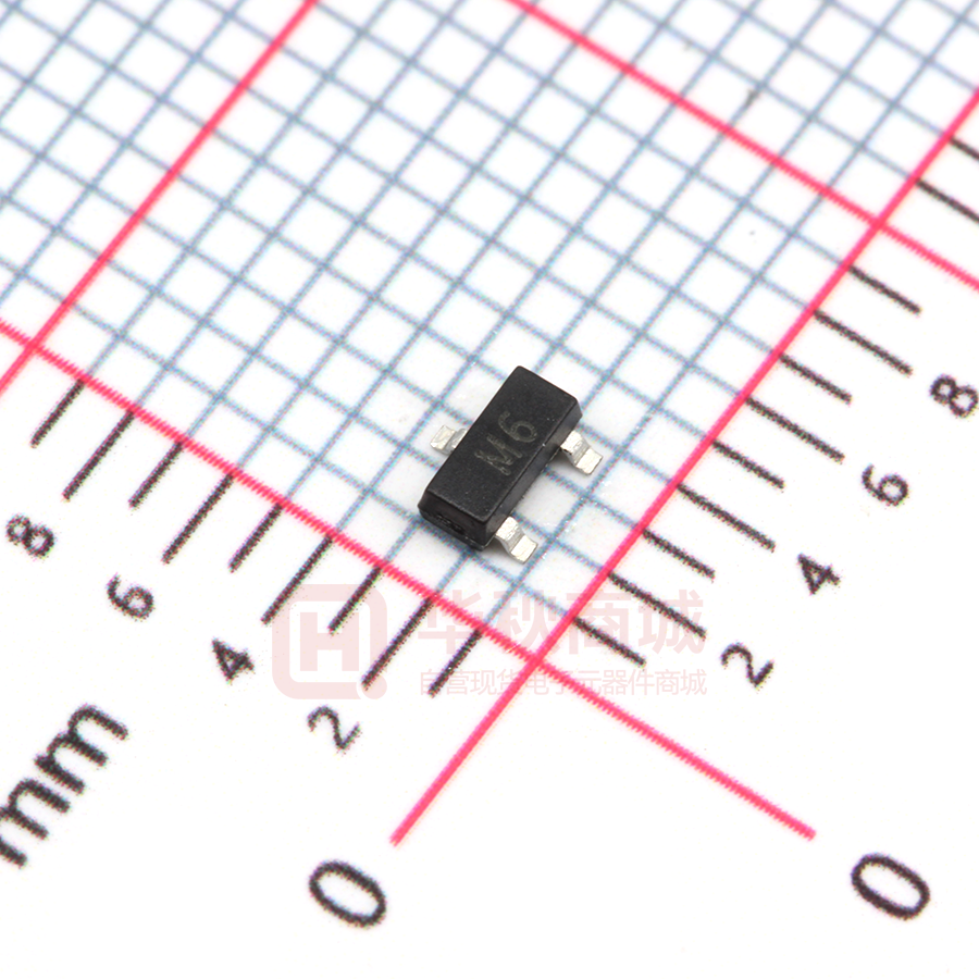

    TWGMC(台湾迪嘉)
    SOT-23
    集电极-基极电压:-50V 集电极-发射极电压:-45V 集电极电流连续:-0.1A 收集器功耗:0.3W 储存温度:-55-150℃ PNP
S9015 数据手册
S9015 S9015 TRANSISTOR(PNP) FEATURES SOT-23 Complementary to S9014 1.BASE 2.EMITTER 3.COLLECTOR MARKING: M6 MAXIMUM RATINGS (TA=25℃ unless otherwise noted) Symbol Parameter Value Units VCBO Collector-Base Voltage -50 V VCEO Collector-Emitter Voltage -45 V VEBO Emitter-Base Voltage -5 V IC Collector Current -Continuous -0.1 A PC Collector Power Dissipation 0.2 W Tj Junction Temperature 150 ℃ Tstg Storage Temperature -55-150 ℃ ELECTRICAL CHARACTERISTICS (Tamb=25℃ unless otherwise specified) Parameter Symbol Test conditions MIN TYP MAX UNIT Collector-base breakdown voltage V(BR)CBO IC= -100µA, IE=0 -50 V Collector-emitter breakdown voltage V(BR)CEO IC = -0.1mA, IB=0 -45 V Emitter-base breakdown voltage V(BR)EBO IE=-100µA, IC=0 -5 V Collector cut-off current ICBO VCB= -50V, IE=0 -0.1 µA Emitter cut-off current IEBO VEB= -5V, IC=0 -0.1 µA DC current gain hFE VCE= -5V, IC= -1mA 200 450 Collector-emitter saturation voltage VCE(sat) IC= -100mA, IB= -10mA -0.3 V Base-emitter saturation voltage VBE(sat) IC= -100mA, IB=-10mA -1 V Transition frequency www.tw-gmc.com fT VCE= -5V, f=30MHz 1 IC= -10mA 150 MHz S9015 Typical Characteristics Static Characteristic -6 -14uA -12uA -10uA -8uA -6uA -2 IC Ta=25℃ 100 -4uA -0 IB=-2uA -0 -2 -4 -6 COLLECTOR-EMITTER VOLTAGE VCEsat -1 COLLECTOR-EMITTER SATURATION VOLTAGE VCEsat (V) DC CURRENT GAIN -16uA -4 — — Ta=100℃ hFE -20uA -18uA hFE 1000 COMMON EMITTER Ta=25℃ VCE COMMON EMITTER VCE= -5V 10 -0.1 -8 -1 (V) -10 COLLECTOR CURRENT —— IC VBEsat -2 BASE-EMITTER SATURATION VOLTAGE VBEsat (V) COLLECTOR CURRENT IC (mA) -8 -0.1 Ta=100℃ Ta=25℃ —— -1 IC -100 (mA) IC Ta=25℃ Ta=100℃ β=10 β=10 -0.01 -0.2 -1 -10 COLLECTOR CURRENT IC -1 COLLECTOR CURRENT —— VBE fT 1000 — — -100 IC (mA) IC TRANSITION FREQUENCY fT Ta=100℃ -10 Ta=25℃ -1 -0.1 -0.0 COMMON EMITTER VCE=-5V -0.3 -0.6 -0.9 100 COMMON EMITTER VCE=-5V Ta=25℃ 10 -0.1 -1.2 -1 BASE-EMMITER VOLTAGE VBE (V) —— VCB/ VEB Cib -1 CAPACITANCE REVERSE VOLTAGE www.tw-gmc.com -10 VR (V) Ta 100 50 0 25 50 75 AMBIENT TEMPERATURE 2 -100 (mA) 150 0 -20 —— IC 200 (mW) f=1MHz IE=0/IC=0 Ta=25 ℃ Cob 1 -0.1 PC 250 PC C 10 Cob/ Cib -10 COLLECTOR CURRENT COLLECTOR POWER DISSIPATION 30 (pF) -10 (MHz) IC COLLECTOR CURRENT -0.2 (mA) (mA) -100 IC -0.1 -100 100 Ta 125 (℃ ) 150 S9015 PACKAGE OUTLINE Plastic surface mounted package; 3 leads www.tw-gmc.com SOT-23 3
