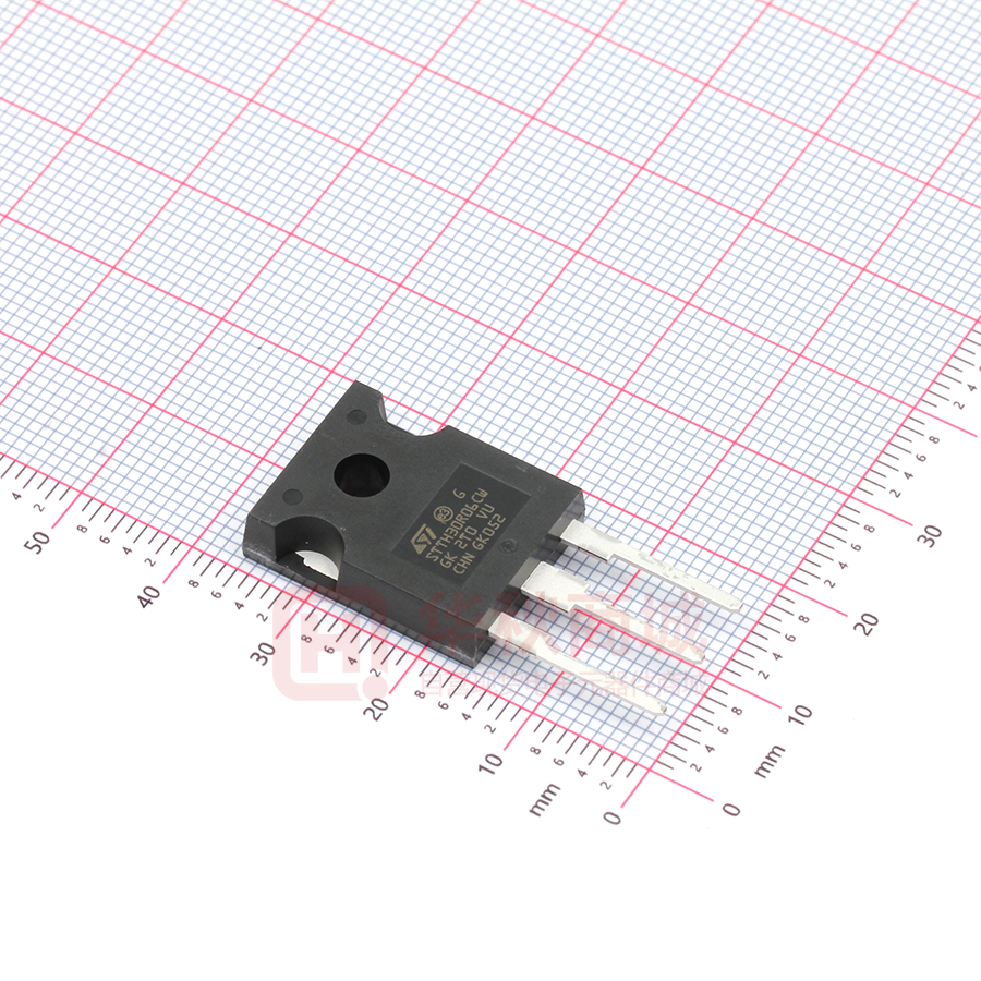

    整流二极管 VRRM=600V If=2X15A VF=2.9V TO247
STTH30R06CW 数据手册
STTH30R06C Turbo 2 ultrafast high voltage rectifier Datasheet - production data Description A1 K This device using ST Turbo 2 600 V technology, is specially suited as boost diode in continuous mode power factor corrections and hard switching conditions. A2 The device is also intended for use as a free wheeling diode in power supplies and other power switching applications. Table 1: Device summary A2 TO-247 Symbol Value IF(AV) 2 x 15 A VRRM 600 V Features IRM (typ.) 8A     Tj (max.) 175 °C VF (typ.) 1.8 V trr (max.) 50 ns K A1 Ultrafast switching Low reverse current Low thermal resistance Reduced switching and conduction losses February 2018 DocID7975 Rev 3 This is information on a product in full production. 1/9 www.st.com Characteristics 1 STTH30R06C Characteristics Table 2: Absolute ratings (limiting values, per diode) Symbol Parameter Value Unit VRRM Repetitive peak reverse voltage 600 V IF(RMS) Forward rms current 30 A IF(AV) Average forward current IFSM Surge non repetitive forward current Tstg Storage temperature range Tj Tc = 115 °C, δ = 0.5, per diode 15 Tc = 100 °C, δ = 0.5, per device 30 tp = 10 ms sinusoidal 120 A -65 to +175 °C 175 °C Max. value Unit Maximum operating junction temperature A Table 3: Thermal parameters Symbol Parameter Rth(j-c) Junction to case Rth(c) Coupling Per diode 1.5 Total 1.0 °C/W 0.5 Table 4: Static electrical characteristics (per diode) Symbol Parameter Test conditions IR(1) Reverse leakage current VF(2) Forward voltage drop Tj = 25 °C Tj = 125 °C Tj = 25 °C Tj = 125 °C VR = VRRM IF = 15 A Notes: (1)Pulse test: tp = 5 ms, δ < 2% (2)Pulse test: tp = 380 μs, δ < 2 % To evaluate the conduction losses, use the following equation: P = 1.16 x IF(AV) + 0.043 x IF2(RMS) 2/9 DocID7975 Rev 3 Min. Typ. - 60 70 - Max. 800 2.9 1.4 1.8 Unit µA V STTH30R06C Characteristics Table 5: Dynamic electrical characteristics Symbol trr IRM S factor Parameters Test conditions Reverse recovery time Tj = 25 °C Reverse recovery current Softness factor Tj = 125 °C Qrr Reverse recovery charges tfr Forward recovery time VFP Forward recovery voltage Tj = 25 °C DocID7975 Rev 3 Min. IF = 0.5 A, Irr = 0.25 A, IR = 1 A - IF = 1 A, dIF/dt = -50 A/μs, VR = 30 V - IF = 15 A, dIF/dt = -200 A/μs, VR = 400 V IF = 15 A, dIF/dt = 120 A/μs, VFR = 1.1 x VFmax Typ. Max. Unit 30 ns 50 - 7.5 - 0.15 - 220 9.0 A nC - 200 ns - 6 V 3/9 Characteristics 1.1 STTH30R06C Characteristics (curves) Figure 1: Conduction losses versus average current (per leg) Figure 2: Forward voltage drop versus forward current (per leg) P(W) 40 δ = 0.05 δ = 0.2 δ = 0.1 120 δ = 0.5 35 IFM(A) 110 δ=1 30 Tj = 125 °C (Maximum values) 100 90 25 80 Tj = 125 °C (Typical values) 70 20 60 15 50 10 Tj = 25 °C (Maximum values) 40 T 30 5 IF(AV)(A) δ =tp/T tp 20 0 10 0 2 4 6 8 10 12 14 16 18 20 VFM(V) 0 0 Figure 3: Relative variation of thermal impedance junction to case versus pulse duration 1.0 0.9 Zth(j-c) /Rth(j-c) Single pulse 0.8 0.7 0.6 0.5 0.4 0.3 0.2 0.1 t P(s) 0.0 1.E-03 1.E-02 1.E-01 1.E+00 1 90 t RR(ns) 80 4 5 6 IRM(A) 28 26 24 22 20 18 16 14 12 10 8 6 4 2 0 V R = 400 V T j = 125 °C IF = 2 x IF(AV) IF = IF(AV) IF = 0.5 x IF(AV) IF = 0.25 x IF(AV) dIF/dt(A/µs) 200 400 600 800 1000 Figure 6: Reverse recovery charges versus dIF/dt (typical values, per leg) 600 V R = 400 V T j = 125 °C 3 Figure 4: Peak reverse recovery current versus dIF/dt (typical values, per leg) 0 Figure 5: Reverse recovery time versus dIF/dt (typical values, per leg) 2 Q RR(nC) VR = 400 V Tj = 125 °C 550 IF = 2 x IF(AV) 500 70 IF = 2 x IF(AV) 450 60 IF = IF(AV) 400 IF = IF(AV) IF = 0.5 x IF(AV) 350 50 300 40 250 30 200 IF = 0.5 x IF(AV) 150 20 100 10 dIF/dt(A/µs) 0 0 4/9 200 400 600 800 50 1000 DocID7975 Rev 3 dIF/dt(A/µs) 0 0 200 400 600 800 1000 STTH30R06C Characteristics Figure 7: Softness factor versus dIF/dt (typical values, per leg) 0.35 Figure 8: Relative variation of dynamic parameters versus junction temperature Sfactor 2.50 IF ≤ 2 x IF(AV) V R = 400 V T j = 125 °C 0.30 IF = IF(AV) V R = 400 V Reference: T j = 125 °C 2.25 S factor 2.00 1.75 1.50 0.25 1.25 1.00 0.20 IRM 0.75 0.50 0.15 Q RR 0.25 dIF/dt(A/µs) 0.10 0 200 400 600 800 25 1000 Figure 9: Transient peak forward voltage versus dIF/dt (typical values, per leg) 11 VFP(V) 50 75 100 t FR(ns) IF = IF(AV) V FR = 1.1 x V F max. T j = 125 °C 200 9 180 8 160 7 140 6 120 5 100 4 80 3 60 2 125 Figure 10: Forward recovery time versus dIF/dt (typical values, per leg) 220 IF = IF(AV) T j = 125 °C 10 Tj (°C) 0.00 40 1 20 dIF/dt(A/µs) 0 dIF/dt(A/µs) 0 0 100 200 300 400 500 0 100 200 300 400 500 Figure 11: Junction capacitance versus reverse voltage applied (typical values, per leg) 1000 C(pF) F = 1 MHz Vosc = 30 mV RMS T j = 25 °C 100 VR(V) 10 1 10 DocID7975 Rev 3 100 1000 5/9 Package information 2 STTH30R06C Package information In order to meet environmental requirements, ST offers these devices in different grades of ECOPACK® packages, depending on their level of environmental compliance. ECOPACK ® specifications, grade definitions and product status are available at: www.st.com. ECOPACK® is an ST trademark.     2.1 Epoxy meets UL94, V0 Cooling method: by conduction (C) Recommended torque values: 0.8 N·m Maximum torque value: 1.0 N·m TO-247 package information Figure 12: TO-247 package outline 6/9 DocID7975 Rev 3 STTH30R06C Package information Table 6: TO-247 package mechanical data Dimensions Ref. Millimeters Min. Typ. Inches Max. Min. Typ. Max. A 4.85 5.15 0.191 0.203 A1 2.20 2.60 0.086 0.102 b 1.00 1.40 0.039 0.055 b1 2.00 2.40 0.078 0.094 b2 3.00 3.40 0.118 0.133 c 0.40 0.80 0.015 0.031 D(1) 19.85 20.15 0.781 0.793 E 15.45 15.75 0.608 0.620 e 5.30 5.60 0.209 L 14.20 14.80 0.559 0.582 L1 3.70 4.30 0.145 0.169 L2 5.45 18.50 0.215 0.220 0.728 ØP(2) 3.55 3.65 0.139 0.143 ØR 4.50 5.50 0.177 0.217 S 5.30 5.70 0.209 5.50 0.216 0.224 Notes: (1)Dimension (2)Resin D plus gate protusion does not exceed 20.5 mm thickness around the mounting hole is not less than 0.9 mm. DocID7975 Rev 3 7/9 Ordering information 3 STTH30R06C Ordering information Table 7: Ordering information 4 Order code Marking Package Weight Base qty. Delivery mode STTH30R06CW STTH30R06CW TO-247 4.36 g 30 Tube Revision history Table 8: Document revision history 8/9 Date Revision Changes July-2001 1 Last issue. 18-Jun-2014 2 Updated title. ECOPACK statement updated. 16-Feb-18 3 Updated Section 1.1: "Characteristics (curves)". DocID7975 Rev 3 STTH30R06C IMPORTANT NOTICE – PLEASE READ CAREFULLY STMicroelectronics NV and its subsidiaries (“ST”) reserve the right to make changes, corrections, enhancements, modifications, and improvements to ST products and/or to this document at any time without notice. Purchasers should obtain the latest relevant information on ST products before placing orders. ST products are sold pursuant to ST’s terms and conditions of sale in place at the time of order acknowledgement. Purchasers are solely responsible for the choice, selection, and use of ST products and ST assumes no liability for application assistance or the design of Purchasers’ products. No license, express or implied, to any intellectual property right is granted by ST herein. Resale of ST products with provisions different from the information set forth herein shall void any warranty granted by ST for such product. ST and the ST logo are trademarks of ST. All other product or service names are the property of their respective owners. Information in this document supersedes and replaces information previously supplied in any prior versions of this document. © 2018 STMicroelectronics – All rights reserved DocID7975 Rev 3 9/9
